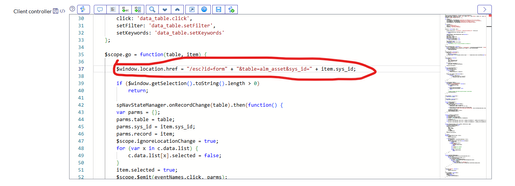

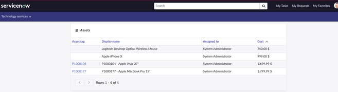

Hi guys, i ve been working on the employee center and i have a problem with my page. I am working with the Data Table widget (clone), which helps me to show the assets that are assigned to me.

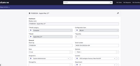

When I click on a record, a new page in employee center opens and i can see the record.
I implemented this in client controller part of my Data Table Widget Clone. Without line 37 the record would not be open.
Now my question is, if it is possible to use a modal for opening the asset record like a pop up window. I dont like it that when i click on a record in the table, a new employee center page opens. Is this possible?
