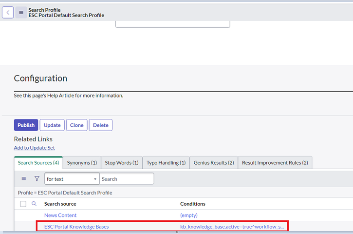

@ParkHyunSun Where are you trying to search articles in portal? In the search bar ?
Also check if AI search is enabled in portal. If its enabled then you need to check that "ESC Portal Knowledge Bases" search source is present in "ESC Portal Default Search Profile" search profile.
Also check condition configured in "ESC Portal Knowledge Bases" search source record.
