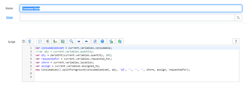

within the workflow this is the code I am using:
Consumables is the current script include and hasn't been modified.

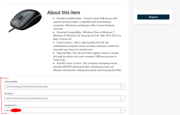

Finally, this is the catalog item I am using to create the request. I have kept the variables visible so it is clear that sysID is being used and not display name
