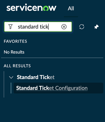

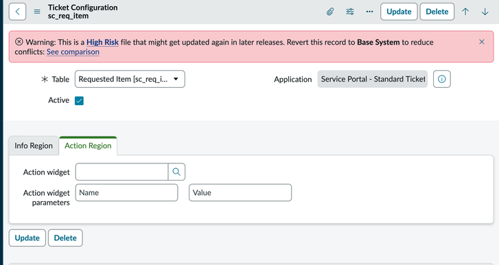

09-26-2025 06:32 PM
Hi @ayushmaan_b ,
Hopefully the customization that was done for the 'Incident Standard Ticket Actions' was done by using the Standard Ticket Configurations module. This module will allow you to do the same thing for RITMS.
Find the correlating 'Standard Ticket Configuration' record for the 'sc_cat_item' table.
Open that record and click the "Action Region" tab and you'll see where to add the widget
Out-of-box it is blank because there isn't a widget specifically for the sc_cat_item. So you can use any of the others as a template to create one.
Result:

09-29-2025 09:11 AM
Hi Chris,
I have followed your steps and tried to copy an existing widget 'Standard Ticket Actions' to ' RITM Standard Ticket Actions'.
However, im lost with Body HTML template,Server script,Client controller code.
Since im not that familiar with coding im getting some errors. Can you help with this.

You need to realize that the Req item is different than an Incident in that there are actually two records (possibly more) to think about 1) The Request and 2) The Request Item(s). So to reiterate, you'll need to be familiar with your process and make the modifications that suit your process.
I hope this helps.
