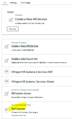

The solution you provided did make the "People" tab invisible but other employee's still do show up in the search result as shown in the screenshot below. The requirement is also to not show Other employees (users) in the search results anymore. Please can you guide me on how to achieve this too.

So for this we will need to go to the Search Profiles and unlink the Search Source.
Click on the profile you are using, I think you are using the same as me, but it will look like this:
Use the Search Source tab under Configuration. Select the checkbox next to ESC Portal People (if you are using the same as me).
When checked, Click Unlink Selected (don't worry, we can always easily bring these back if needed).
Now, your profile, with this change, will need to be published again. Making a change to the profile always brings it back to draft. Go ahead and publish it and check your portal (refresh the URL).
