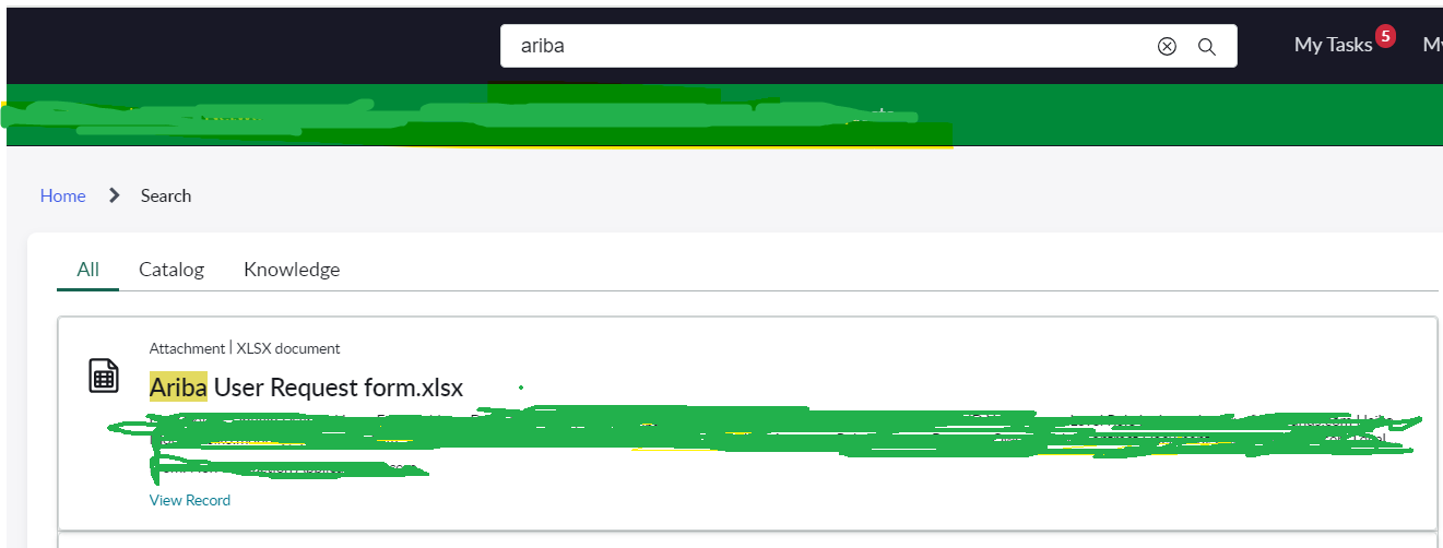

Hey All,
I have a need to exclude attachments from the search results in the Employee Center on the search engine. My objective is to specifically view pertinent Knowledge Base articles and Request Items (RITMs), excluding any associated attachments.
Does anyone know how it can be controlled?
Many thanks,
Charishma M.
