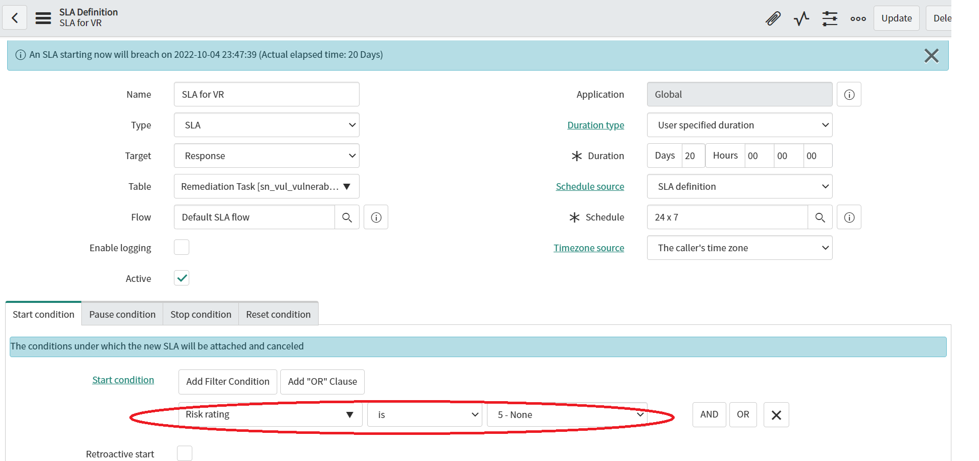

I have given start condition, then also SLA is not attaching to Vul.group. You can see the configuration in attachment.
That's strange. It should work like this. Just to be sure: did you create a new one on Risk rating '5' or change the Risk rating to '5' on an existing one? The start condition needs to be triggered. If that still doesn't work: log a ticket with NowSupport, because everything is configured correctly as far as I can see.
Mark
Thanks Mark for your reply. After the schedule job ran, new Vul.groups were updated.Now I can see SLA attached
