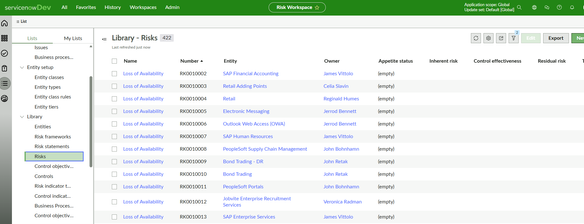

You can see the all the active risks in workspace as part of the Risk Workspace -> Lists Tab -> Library -> Risks.
It will have the filter for getting only the active risks which are not in retired state.

Hello @AshokeG ,
You can see all the Risks by navigating Risk Workspace > Lists :

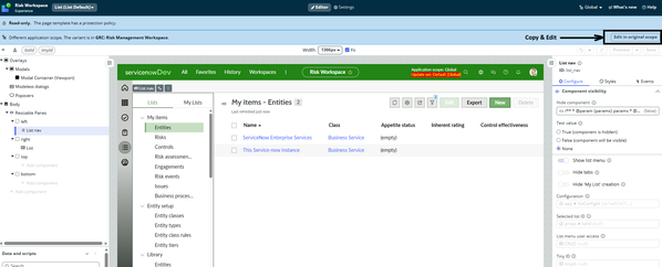

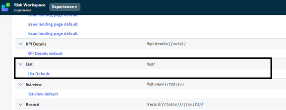

AND If you want to customize the UI Page,
Then Navigate to UI Builder > Experiences > Risk Workspace > List :
Note : Duplicate the ootb page then customize or filter out according to your requirement..
