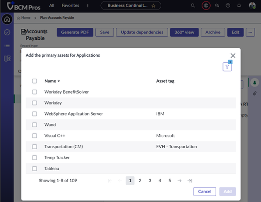

When you go into the plan from the BCM Workspace, did you select the scope tab, select the add primary scope button, then select the asset and add? (Screenshot below)
Once you've done that you should then select the update dependencies button.
If a BIA has been done for that asset AND if that BIA included dependencies, then those dependencies will be pulled in shortly after clicking the button.

If it's taking too long to update, I would check your dependency update configuration record. It may be set to pull in everything from everywhere, and depending on your sources, that could take quite a while.
Configure the Impact analysis dependency update configuration record
