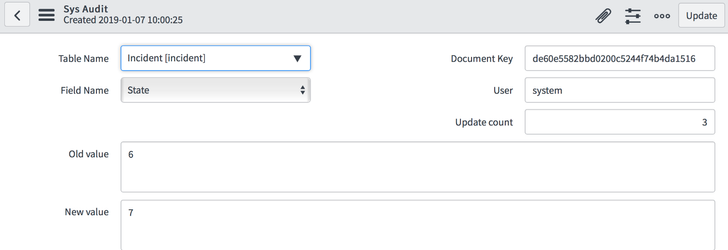

For example, if auditing is enabled for the State field on the Incident table, changing the value of the State field in an Incident record would generate an audit entry that looks something like this:

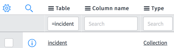

  • Filter the List: In the Dictionary section, you’ll see a list of records. To find the specific table you want to configure for auditing, utilize the filtering options available at the top of the list. Enter the relevant table name to narrow down the results effectively.
  • Check the Record Type: After locating the record, ensure that the Type field is set to Collection. This confirms that you have selected the correct table for which you intend to enable auditing.
  • If the Audit  column isn’t visible in the list, click the gear icon to adjust the list settings and include the Audit field.
  • Once the Audit column is displayed, double-click on the corresponding cell for the record you wish to modify.
  • The field will then become editable. You can change the value to either true or false, depending on whether you want to enable or disable auditing for that table. Use true to turn on auditing for the selected table, or false to turn it off,
  • After making the necessary selection, click the green check icon to save the change.

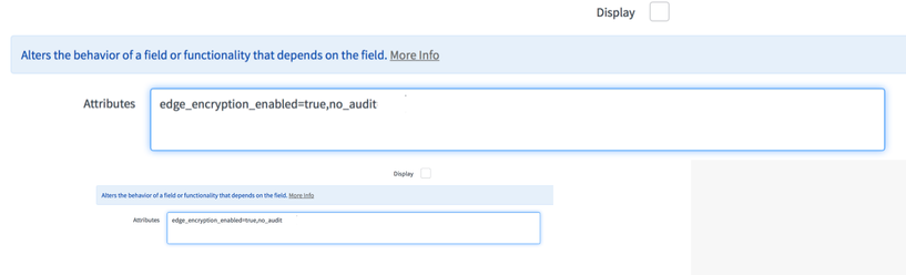

  • Access the Field Record : Once you’ve identified the correct record for the selected field, click on the related link labeled Advanced view. This action will provide you with a more detailed display of the record, allowing for easier modifications.
  • Locate the Attributes Field : Within the advanced view, look for the **Attributes** text box associated with this record. This field is where you will input the necessary parameters to configure auditing settings.
  • Disable Auditing : To disable auditing for this field under an exclusion list auditing scheme, you need to add the text no_audit to the Attributes field. If there are already values present in this text box, make sure to place a comma after the last attribute before appending no_audit. This ensures that all attributes are properly separated. Conversely, if the Attributes field is currently empty, simply enter no_audit directly into the text box.
  • Save Changes : After adding this attribute, it’s essential to click the Update button to save your changes. This action finalizes your configuration and ensures that the auditing settings for the specified field are applied correctly.
