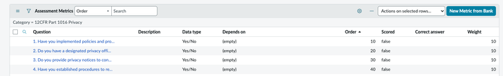

I'm trying to figure out how does the integration between TPRM and Control objective/control works.
I was able to set up a metric (question) -> link it to CO -> I see link in assessment metrics on CO->I've linked the entity (Vendor) to CO -> control was generated -> I've pushed control to monitor state-> done the vendor assessment.
I see the results of vendor assessment on control record in "vendor risk assessment questions" but the status of the control has not changed.
What should I do to make it work?
Connor Levien
@Michal Sloniews from memory you have to specify a correct answer in the assessment metrics for it to auto mark it as effective or ineffective using OOTB logic
However, as this is a bit old most customer either build a flow or action to set the control status via the smart assessment or when the question is linked to the control.
