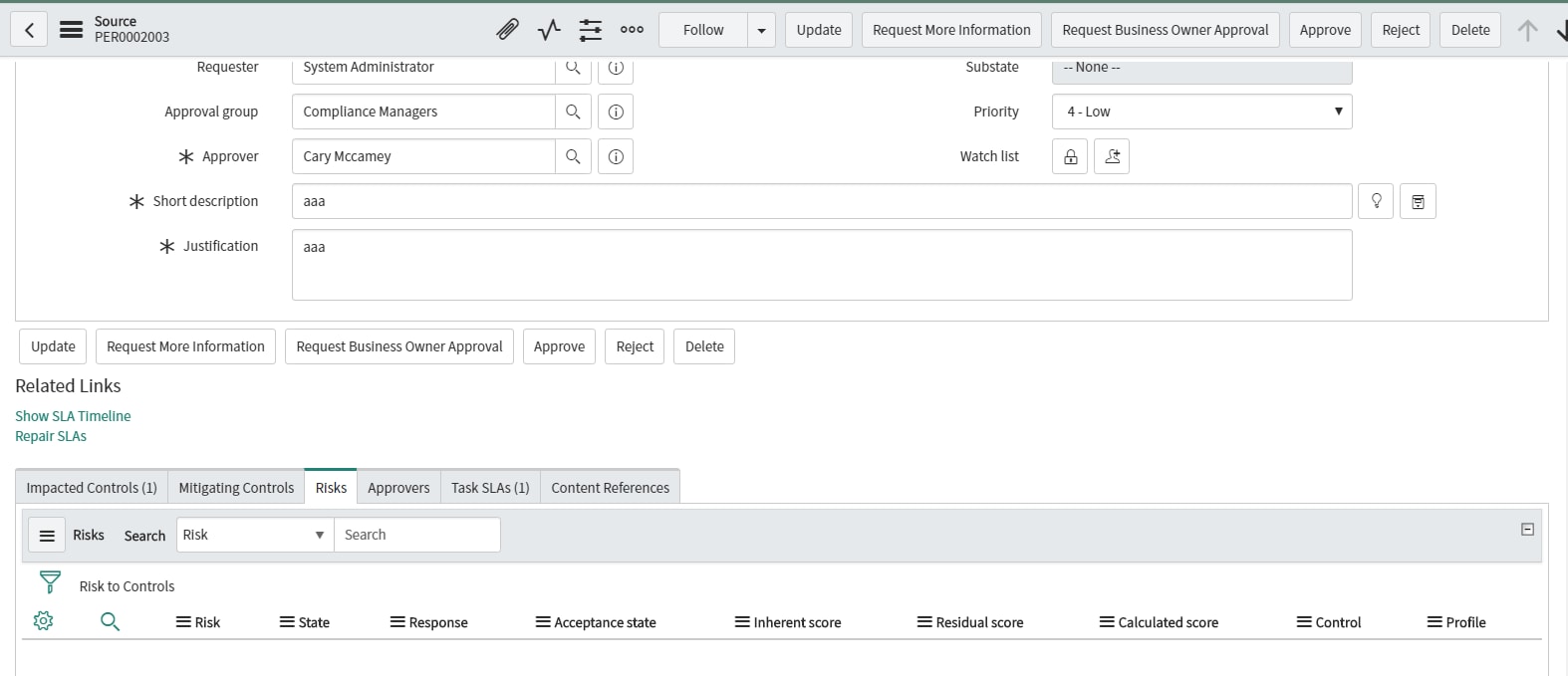

Check for the applicable control, if you have created a risk there (under controls), then during Policy Exception Approval phase, you get the "Request Risk Assessment" option. (Check the screenshot below)
If under the applicable control, there is no risk created then "Request Risk Assessment" option does not appear. (Check the 2nd screenshot.)

Hi Anitha,
This completely makes sense why i'm not able to see the risk assessment phase. Thank you for explaining with screenshots.

Niharika,
As Anithanarayan mentioned, the 'Requests Risk Assessment' option will be available only if your controls have associated risks.  Typically risk creation process is independent of policy exception process. So you could create risks and in your risk register and associate them with controls and when you request policy exception for those controls, you would be able to perform risk assessment on them as well.
