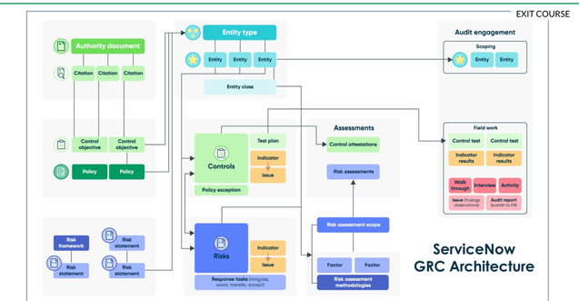

Level1:
Control Objective is the Template that defines what should be adhered to.
Entity Type is the reference to the list of records with or without a defined filter of ServiceNow. Every record of it is called Entity.
Ex: Entity Type is Windows Servers, with Entity Owner defined here.
All the windows servers becomes Entities.
Level2:
When the Entity Type and Control Objective are connected, Every Entity generated through the Entity Type gets a control attached to it with Entity Owner as the Control Owner, also Risk Owner if a Risk Statement would be have attached to the Entity Type.

backend process for control generation in ServiceNow GRC:
How Controls Are Generated
When you link an Entity Type to a Control Objective, ServiceNow’s Item Generation engine (a.k.a. Control Synthesis) creates a Control record for each matching entity.
The new control is stored in sn_grc_control.
How Control Owner is Assigned
By default, the Entity Owner (owned_by field on the entity) is copied into the Control Owner (owned_by on the control).
This happens because the “Sync with Entity Owner” option is enabled by default.
If unchecked, you can assign a different owner manually.
Mechanism Behind the Scenes
Driven by backend scripts/flows (e.g., item generation engine, script includes, BRs).
Works automatically and often runs asynchronously.
No need to manually create controls—relationships drive the creation.
In short:
Entity + Control Objective → Control auto-generated.
Entity Owner → becomes Control Owner (via sync).
