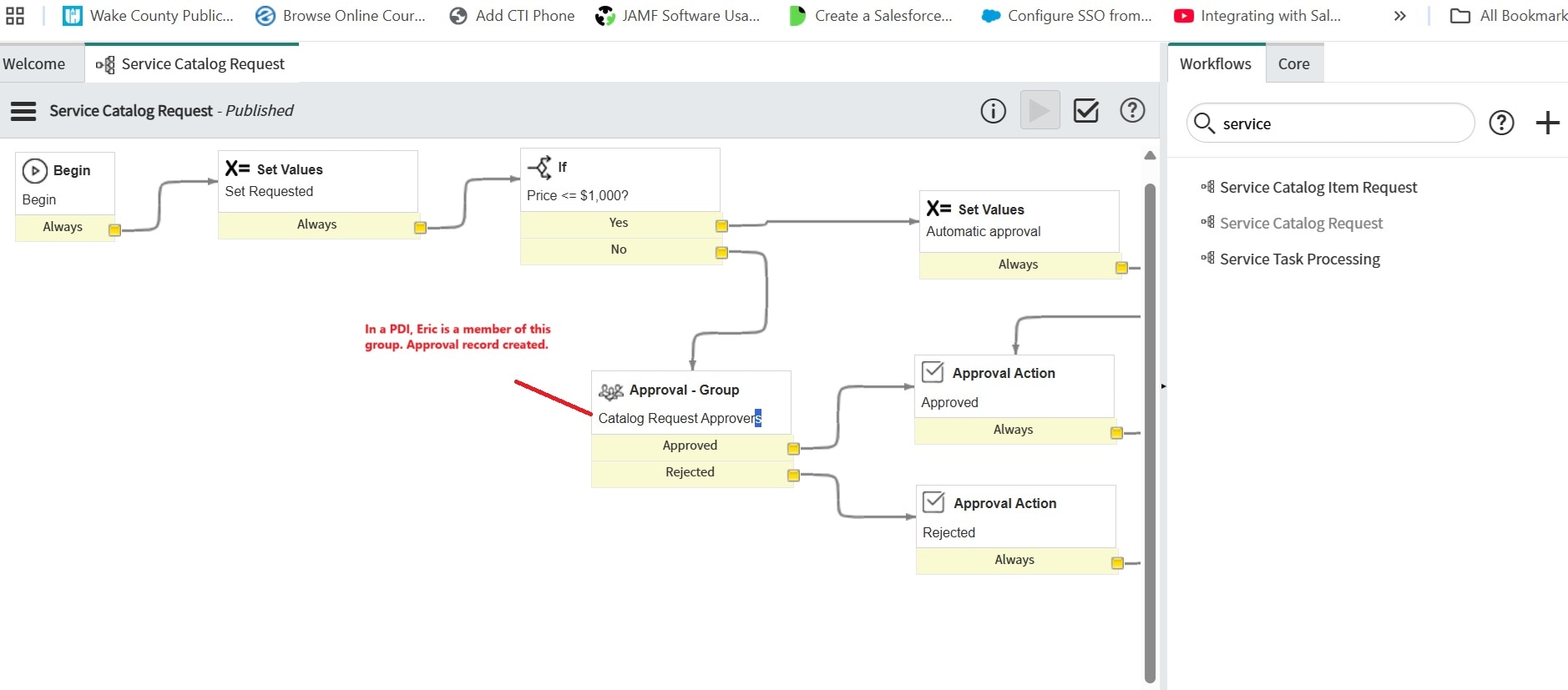

It would be helpful if you provided a few more details as to what you are seeing or tested with. I took a look in my PDI for a workflow that sounded similar to what you mentioned and have a screenshot attached. When the cost is greater than 1000 it goes to a group and Eric is a member of that group. I have seen most companies change from the out of box version. You can use workflow or flow designer. SN said they will stop shipping or enabling workflow after Zurich I think...so may want to use flow depending on your requirements.
