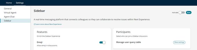

Hi Catherine,
I was looking for a solution to this as well and I was able to remove the "Discuss" button by following these steps:
1. Go to Conversational Interfaces > Settings in the filter navigator
2. Once the settings page loads select the "Sidebar" tab
3. On the right side of the screen deactivate Sidebar (you will need to be in the Omni-Experience Standard Feature Set application scope)
Once Sidebar is disabled the "Discuss" button should no longer appear in the HR agent workspace.
Hope this helps!
