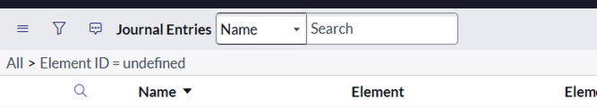

Hi Team,
I need to filter the data based on a particular assignment group from the HR Core Case table.
Since the element ID does not have one of the options, I have decided to write a script include and add those in the element ID filter.
I have tried below script, but it is showing as undefined.
Client callable is yes, and the script is active.

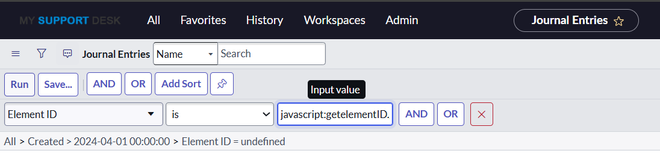

 Filter script : javascript:getelementID.getelementID()
Name of the script include is getelementID.

The Element ID field is char type and not string and hence it won't be supporting IS ONE OF operator and hence it won't work
You can use left nav module and then add this in the filter condition

Then call it like this in left nav module and see
Element ID [IS ONE OF] javascript: new getelementID().getRecords();

In your condition you need to initialize the script include so it will need to be
@Chaz I have tried these method but still I am getting error it is populating as [object object].
I have modified the script include with few other methods but same issue.
