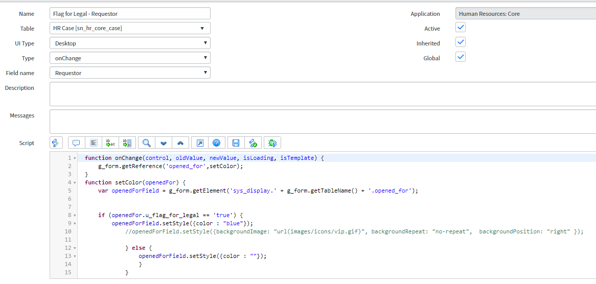

I am trying to, for the most part, copy what the VIP flag client script does - but with a different field and different color (to start).
Here is what I have thus far:
The icon part will most likely come out OR be changed so something else later.. But, my main part right now is that I want to flag the user as a different color. But, the color is not showing up at all - just the icon.
Is there another part to this I am missing?

Welp - I thought it was going to be something silly, and sure enough it turned out to be, something silly...
Order field is not normally on my client script forms. I added it one (after reading another post), and gave my scripts an order. Because we have two for VIP on both Requestor and Subject Person, and then two for my flag on both of those fields also.
Now my color is sticking like I need it to be.
Just, silly Mike!!
Thanks again for all your help here!
-Rob

Hmmm . . . seems to work fine for me. Which field do you have set on the client script?
Hey Michael,
I created two client script (as the one shown), one for subject person and one for requestor (opened_for), just like the regular VIP client scripts..
Both Subject and Requestor are the fields selected for their respected client scripts
I am baffled as to why it is not work. this does not seem really complex 😞
Mine look correct - right?
-Rob
