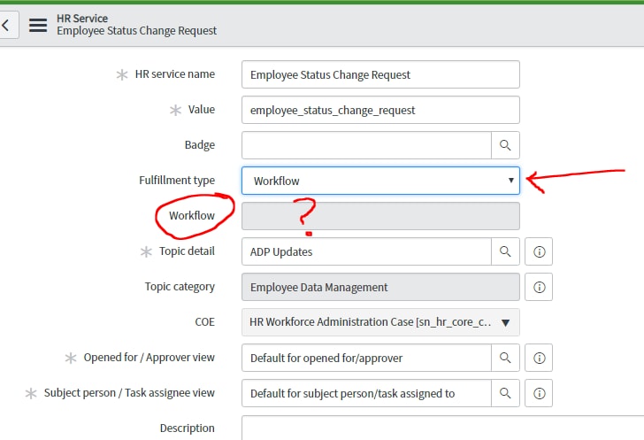

This is in the Scoped HR application in London:
How do I select a workflow for an HR Service when I select "Workflow" for the Fulfillment type?
When I select "Workflow" for the Fulfillment Type field, the workflow field appears, but it is read only.
I tried associating a workflow with the Service's record producer, but that didn't work - it didn't populate the HR Service's workflow field.

Hi Rick!
When using Workflow as the Fulfillment Type for an HR Service, you would define the Workflow in the HR Case Template associated with the HR Service.
I hope this helps!

Thanks Holly,
Where in the template do I select the workflow?
Do I have to "Add a Field" > Workflow > then select the applicable workflow?
Rick
Yes, sir. Add a Field > Workflow > select your workflow, exactly right.
