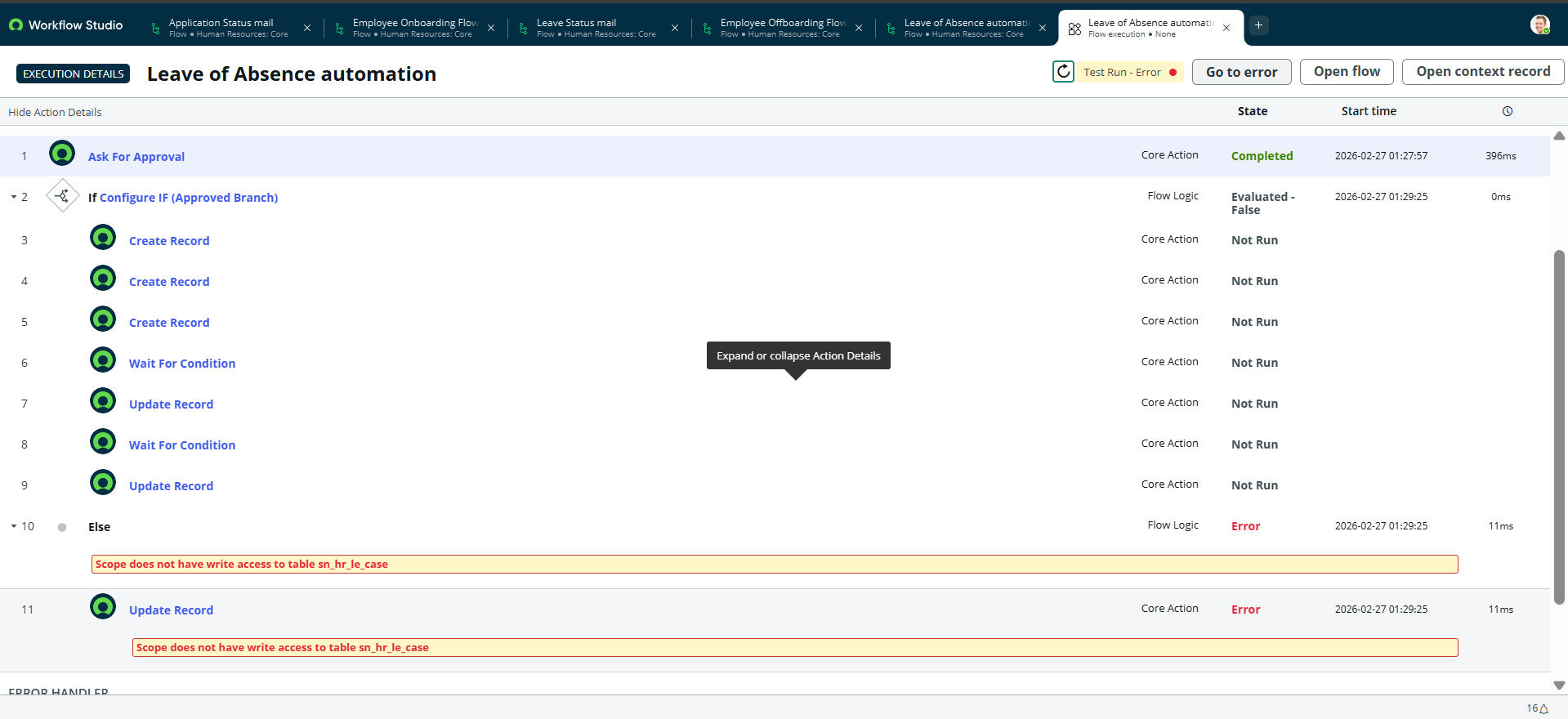

Hi Team,
I am currently working on an Employee Offboarding Flow in Flow Designer (HRSD module). The flow is triggered when an offboarding request is submitted and follows an approval process.
The Approved branch is working as expected, including record creation and updates. However, in the Else (Rejected) branch, I am trying to update a record in the table sn_hr_le_case, and I consistently receive the following error:
“Scope does not have write access to table sn_hr_le_case”
Some details:
Application scope: Custom scoped application
Table being updated: sn_hr_le_case
Action used: Update Record (Flow Designer)
Error occurs only in the Rejected (Else) branch
Other flows like Onboarding and Leave Automation are working with current roles

This error happens because the flow is running from a custom application scope and trying to update a table (sn_hr_le_case) that belongs to the HR Core application scope. HR tables are protected, and by default they don’t allow write access from other scopes. That’s why it only fails in the Rejected branch — that’s the only place where your flow actually tries to update that HR table.
So the issue is not your logic or branch condition. It’s a cross-scope security restriction.

03-02-2026 08:18 PM
no the flow is running in HR Core application scope.
