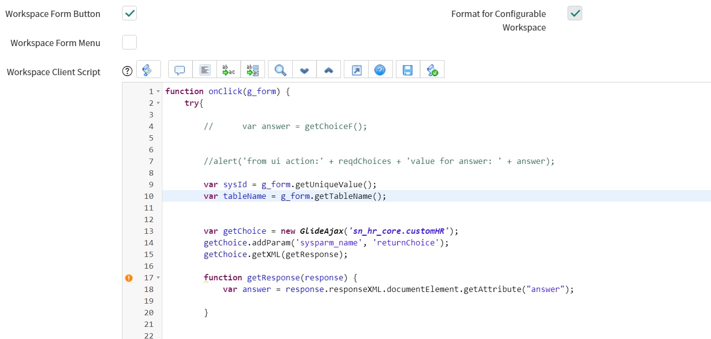

is it not possible to GlideAjax in a workspace client script under given function on onClick, i have tried to execute a simple one to test it out, but the response is not defined. Please find attachment for more detail, i have tried to customize copy of OOB Rescind button ( if additional information is required ).
The try block shows the following error stating : - Reference Error: answer is not defined

It should not be a case. You can see many OOB UI Actions using GLideAjax functionality in workspace client script.
Please put some logs/alerts in both client and server side scripts and see where it is breaking.

Please use getXMLAnswer() syntax and try once
getChoice.getXMLAnswer(function(answer){
alert(answer);
