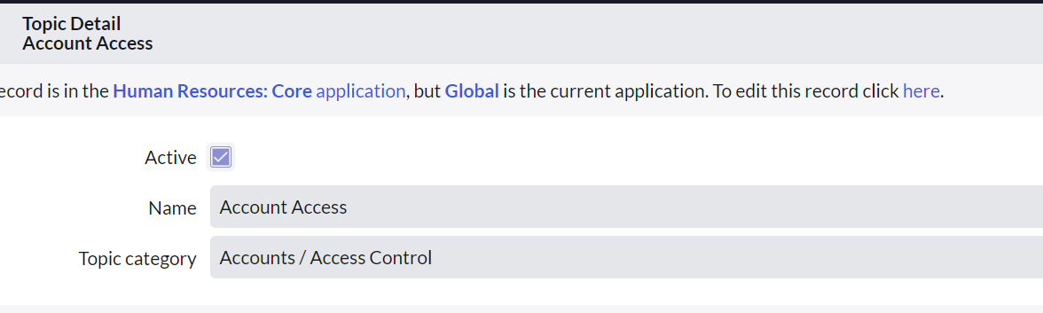

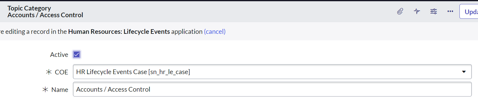

There are three steps are required to build the relationship of COE and HR service:
Step 1 Define Topic Category relationship with COE
Step 2 - Define Topic Detail relationship with Topic Category
Step 3 - Define HR Service Relationship with COE after you select Topic Detail
