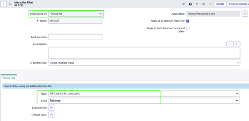

1. Go to Interactive Filter module and click New.
2. Select 'Filter based on' field as 'Choice list',
    Set the 'Name' field (eg. HR COE),
    Select 'Table' as 'HR Case [sn_hr_core_case]',
    and 'Field' as a Task type.
3. Save the form.

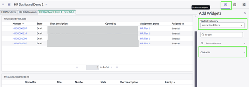

4. Go to Dashboard and click on Add widget icon at the right top.

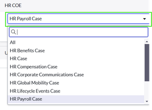

5. Select 'Widget category' as 'Interactive filters', and click on Choice list.
6. Select the created interactive filter(i.e, HR COE). And click on Add button.

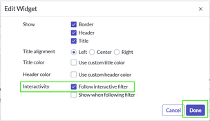

7. The report that want to filter select filter widget icon and check Interactivity = Follow interactive filter.
8. Then apply filter and see filtered reports.
