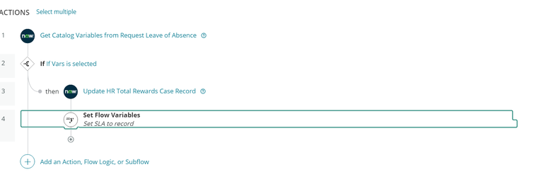

So I found out a way where you can achieve this in flow designer itself. Follow below steps

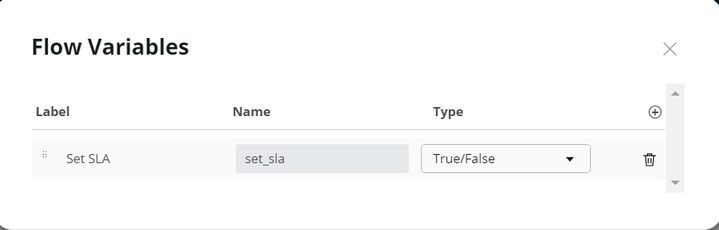

1) Create flow variable called as "Set SLA" of type True/False as below
2) You won't be able to add SLA to record while updating record. So, you need add one more flow logic called as "Set flow variables" (This available under flow logic) and add below script into it
var grSetSLA = new GlideRecord('task_sla');
grSetSLA.sla = 'f29232209f22120047a2d126c42e70f9'; // sys id of SLA definition which you created
grSetSLA.task = fd_data.trigger.table_name.sys_id; // sys of a HR case
if (grSetSLA.insert())
return true;
