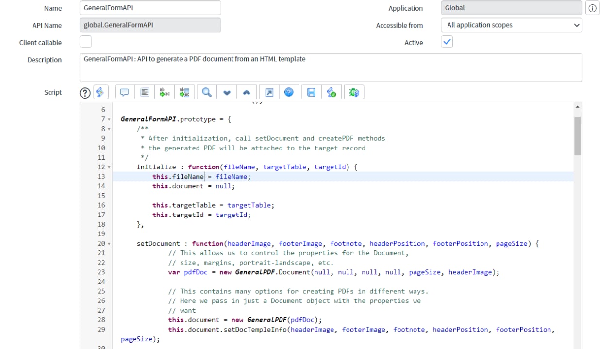

I have a requirement with my client to develop a custom PDF, processing data derived from a catalog request. However, I am having trouble setting the PDF to landscape. I've utilised the GeneralFormAPI script includes and there's even a reference to setting landscape. However, it calls the GeneralPDF script includes setting the Landscape variable to null.
Does anyone know of a method to set the page to Landscape?

Hi @dbasi You have to do this at the PDF document level (the one that you upload into ServiceNow to create the Template. Changing the orientation is not supported when the PDF is generated but you can create the Adobe document in Landscape, and this will work. It will be presented and printed in landscape as well.

Did you try passing the true as the parameter to GeneralPDF.document method.
like this replace null with true and try.
var pdfDoc = new GeneralPDF.Document(true, null, null, null, pageSize, headerImage);
also in the GeneralPDF.Document function, change this.landscape= false to
this.landscape = true;
As per the method documentation it should help you generate PDF in landscape mode.

@Muhammad I've tested this and there is no change to the orientation.
