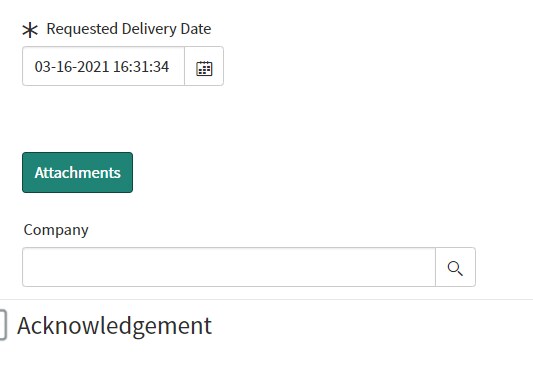

I'm personally not a fan of the attachment variable type. There may be something more to this that I'm not aware of, but from what I can see I am absolutely shocked that ServiceNow has implemented it this way. First of all, you can only add one file, and it (almost) replicates existing functionality, so what is the point? And putting the attachment in the Work note instead of where it belongs? Wwwhhhyyy? So much confusion. I've used a Macro variable with this simple XML to create an Attachments button that I can order wherever within the variables, and it opens the same dialog window as the the paper clip, so same functionality, no excessive records on the attachments table, and they appear where you expect them to. This method doesn't work in Service Portal since Macro variables are not supported.
<button class="request_catalog_button_with_icon btn cat-btn btn-primary" onclick='attach()'>Attachments</button>
