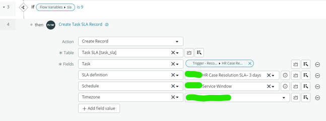

I have a flow that is triggering the SLA and the assignment groups. For context, you have a record producer with a select box variable, and depending on the choice it triggers different SLA's and/or assignment groups. The problem is that, SLA is counting normally, but it's not displaying the % of it on HR Case list.
I will leave a print showing it, if anyone can help, gladly appreciate it!

Hi @anubhavritolia  and @AndersBGS , here is better explained:
The issue I am dealing with is:
I created a flow that will create an SLA manually . It's a customization that I need it like that and cannot be changed.
When I create an HR Case through the flow, the SLA field appears empty
But the Task SLA fields are still counting:
Every case that are opened directly though this customization will have this behavior, but when you create a case where the HR Service of the record producer is in the SLA Definiton works properly as OOB behavior.
