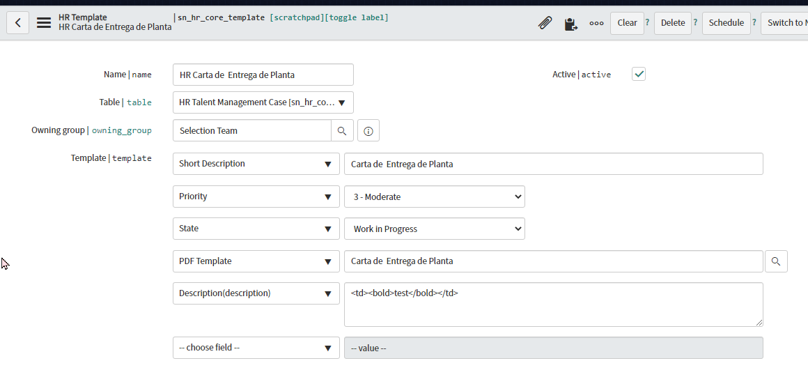

Hey, I had a requirement similar where dynamically I had to add complex information. I saw the document template script and it sounds familiar (such as email template).
If you notice, the only thing that you send is just html so... an alternative is that you can use an auxiliary field where you are going to populate before an instert by a BR with all your code in HTML.
At least it works for me.
I did my test just using hr task template
Regards!
