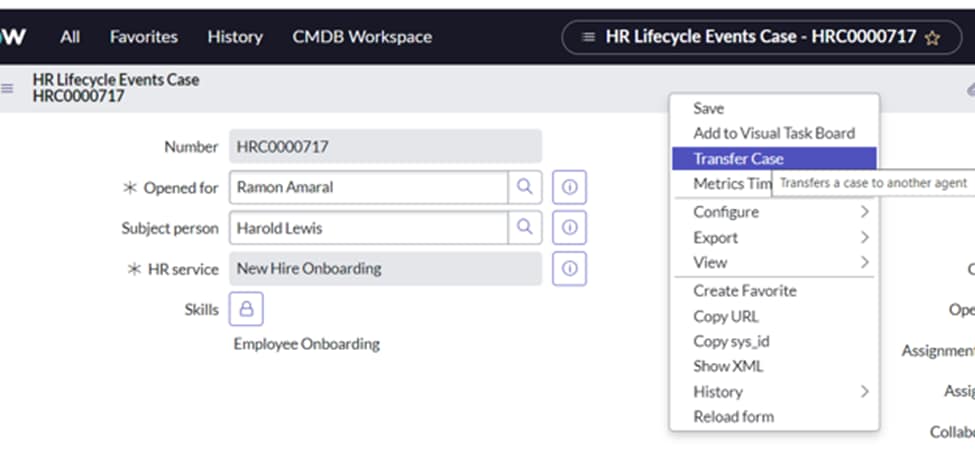

We have facing one issue- when a user submitted their HR case on wrong HR Service, or COE case, so we like to transfer to correct COE case.  I read some posts and  ServiceNow release documents- know current ServiceNow release has HR transfer feature, but somehow it doesn't work for us.   Please advise.

@Pece as you know current ServiceNow release has Out-of-box (OOB) feature to transfer HR case from one COE to another COE. You need to do some configuration to use this OOB feature.
You can create and use methods to reclassify or transfer an opened HR case from one HR service to another.
The reclassify method is that the HR case number does not change after transferring an HR case from one HR service to another with linking redirect to the new case.  However Standard method is that the HR case number changes when transferring an HR case from one HR service to another. Both HR case numbers appear on the HR case for reference
Please following configure steps:
  1. Activate “Transfer Case” UI action, which is “false” in default.

  3. Ensure the following 3 the existing script includes are “Active”
    • hr_TransferCase
    • ReclassifyCaseTransfer
    • StandardCaseTransfer
You can perform you HR case transfer following steps:

Thank you John.  I activated "Transfer Case" UI action and then works.
