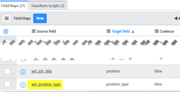

Depending how you differentiate these workers (I'm assuming a "worker type" field that labels as contractor or contingent), you will need to see if that field is currently being brought into ServiceNow by the integration. Underneath the Workday menu > Transform Maps, find the Workday_Data_Transform and look through the Field Map related list to see if the field may exist already.

I am just finally getting a chance to test this today. I am trying to exclude contractors at this points so I attempted to use what you provided above for that, but it doesn't seem to be working for me. I was told the transform piece of the script wasn't really necessary so I left it out (although I have since tested it with that and found it still didn't work).
When the original code you provided didn't work, I edited the source field name to match the field we have in the transform field map and the value it would return for contractors:
