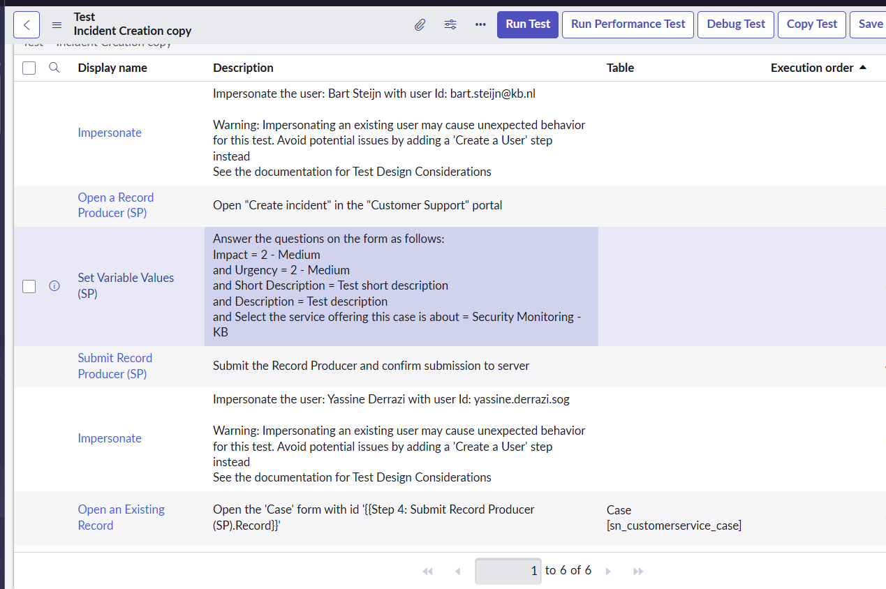

I am creating an ATF test where:
- A user submits a Record Producer
- A Case is created
- An Incident is automatically created and linked to the Case
- An agent opens the Case and then opens the linked Incident
- The agent clicks Assign to me
I can submit the Record Producer and open the Case.

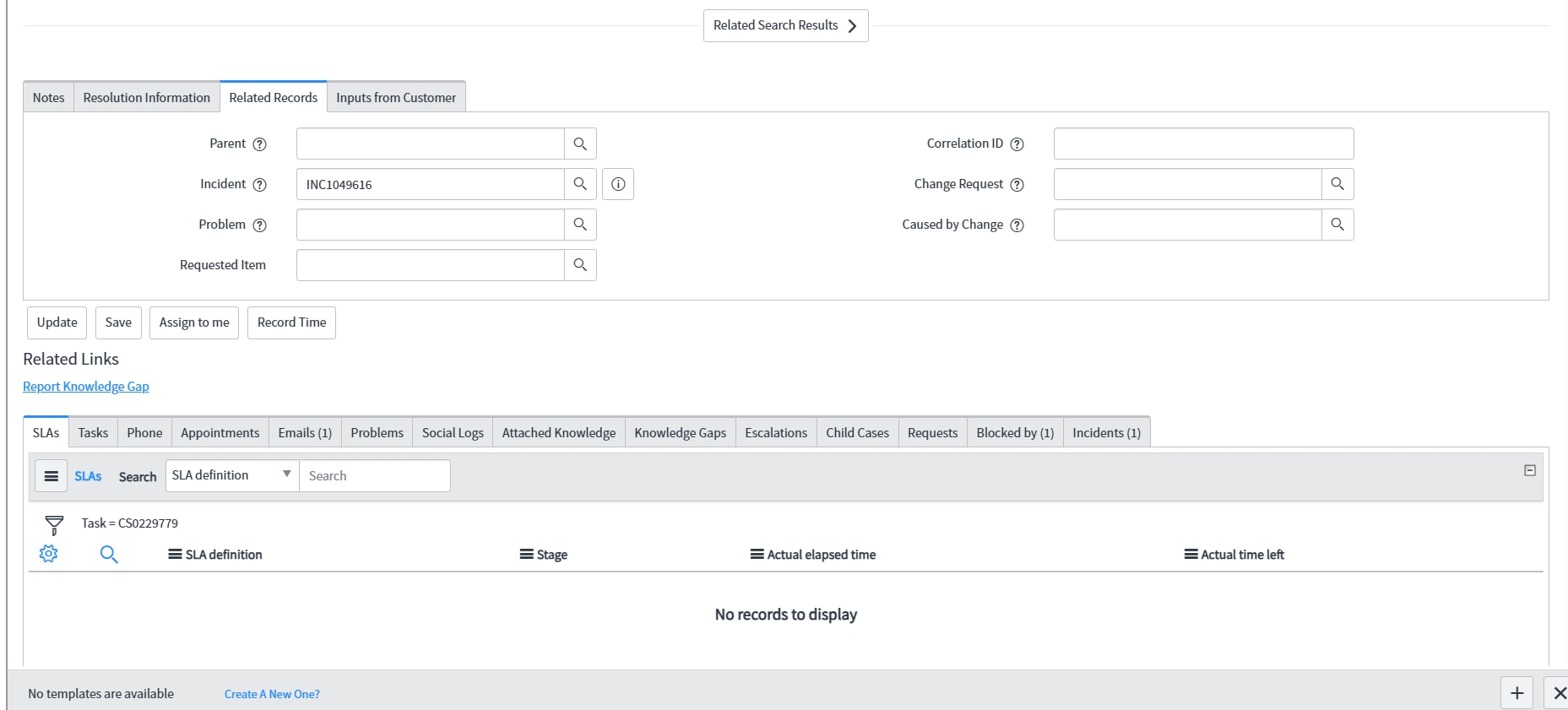

‎04-17-2026 06:03 AM
You can use 'Validate Record Present in List' Test Step to validate if the record is actually created. Then use 'Open an existing record' step to open the record. Check below screenshot for reference
