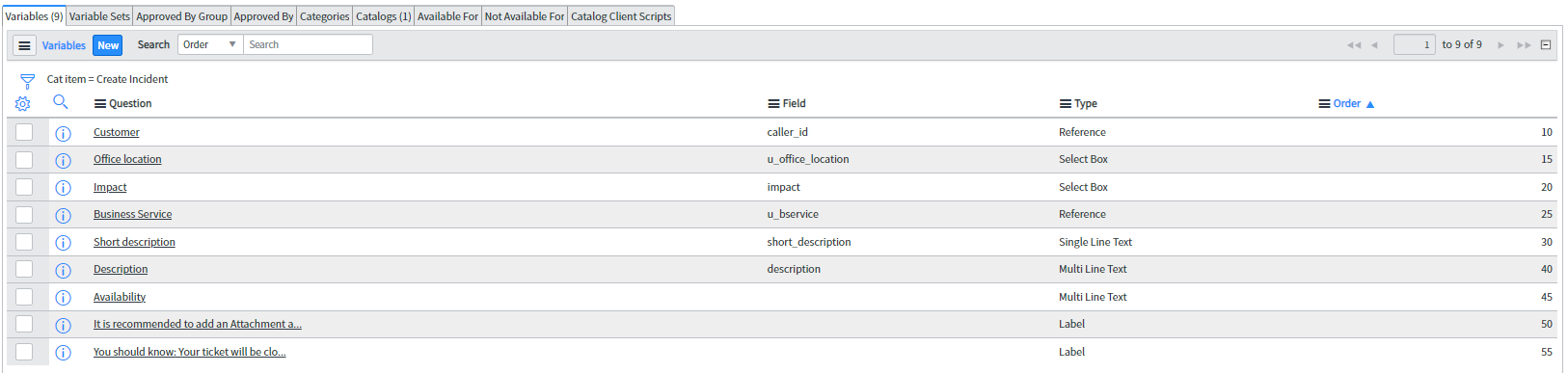

I tried entering the second script but it did not work. I've attached it for you to check. I've also attached the variables just in case.

I think I've worked it out. I've changed your script to
current.incidentlocationfieldname = producer.caller_id.location;
and it seems to have worked!
