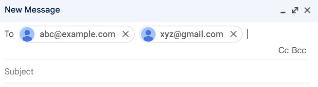

Hi Team,
I have two different email accounts like 1st domain is abc@example.com its creates the incident record that fine   as well 2nd domain contains xyz@exmple.com its creates problem ticket. now i want to while sending email to contains abc@example.com and xyx@example.com mention it will create at a time two records posible ?   Recipients not taking the two emails at a time it will taking either one and create record.
