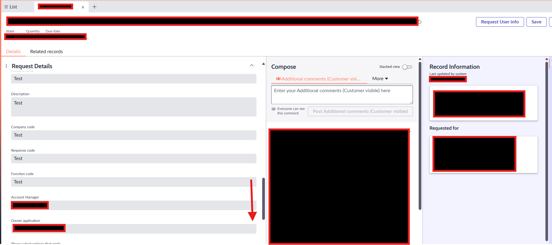

‎07-31-2025 03:09 AM
Hello!
Thank you for the reply! It is for the Service Operations Workspace. The reference field is read only, and on another reference field I do have the info button:
For the field i need it, is is not present:
‎07-31-2025 03:23 AM
see my below response.
If you are on Yokohama then it's a known bug.
