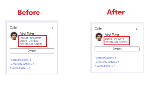

I am really stuck on this one.  I need to change the Caller information that is displayed in the Record Information contextual sidebar but I can't find anything for Xanadu or Yokohama; everything I find is completely different from how it exists today.
All I want to do is replace the Title and Time Zone with Department and Division.  Can someone detail the steps for me, please?

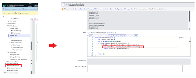

@gjz Record information page uses a data resource "Record Information" which calls the script include.

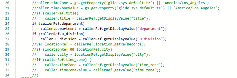

The above information which you looking for/trying to modify comes from the "SOWIncidentInfoSNC" script include which holds a function "getCallerInfo" and its is actually a read only file.
You might need to override the function using editable script include "SOWIncidentInfo" provided by ServiceNow.
Results :  Commented the syntax used for "Department" and the caller card displays without it.

Thanks for the information, but it appears to be only part of the solution.  When I comment out the section you listed, it still displays a time and undefined time zone.  When I replaced the unwanted fields with my custom fields, it didn't display.  My assumption is the card fields are defined in a different location, but where?
