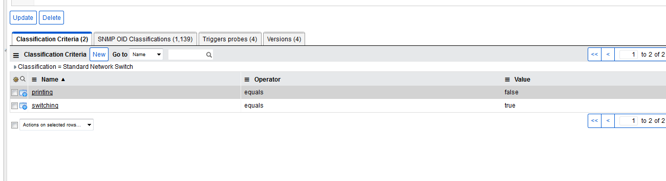

Faisal, thank you for the quick reply. I went thru all the input queues and the only one that had a "SnmpObjectId" line was the one in the second picture I attached to the first post. You can see it on the last line. This was from the input queue named "SNMP - Classify 343OIDs"
Hello Jeff,
I could be wrong but my thought is that even though you have the oid listed in the ECC input queue but that is not the oid parameter system is looking for to determine if that is the switch; therefore, not recognizing as a switch or foundry switch.
As a very temporary measure (maybe first try in DEV), in the Classification Criteria related list, you could say (Source equals "switch IP"), and see if it discovers it.
If you do make that change revert it back as soon as you done.
Thanks, Faisal
Interesting, the source table is already set to Switch IP.
