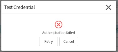

Authentication failed error while running credential test for windows credential
Ajim Shekh
Kilo Contributor
Getting above error while running the credential test for the windows server. I'm doing the Lab 4.3 in SN-DF-No10 ebook.
Anybody could help me with this.

Hi @Ajim Shekh,
Check the credentials you have provided in that Credentials table. It may happen due to wrong credentials.
Tanaji Patil
Though I dont have ebook but I do have some experience in discovery.
Check if-
  1. you have valid MID server. Restart it once.
  2. your MID server is able to communicate over port 135 with the server you are trying to discovery. To ensure this you can do Quick Discovery and check the shazzam response. You should see port 135 open.
    You might also need few of DCOM ports. Default DCOM ports range depends on your operating system-
  3. your credential is specified in this format - Domain\UserName or UserName@example.domain.com. For local account use - .\UserName
  4. IP address you are using is correct. If its discovery of your own machine then IP keeps on changing. In that case get it everytime you run discovery.
If you have these four validated then your credential validation should work.
Hope this helps!
-Please mark helpful/correct based on impact
I had all this fine then also I am getting the error
refer this KB for detailed troubleshooting
https://support.servicenow.com/kb?id=kb_article_view&sysparm_article=KB0657528
