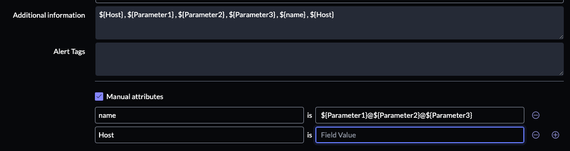

That said, as you know, when using a non-host binding method, you'll remove the Node, give it a class/table to search and then the rule takes into consideration ALL of the variables within Addtional_Info to find a match.
If we're trying to match on an attribute that you don't want to use, we can negate the value (remove it from the search criteria) by adding another manual attribute using the variable name only then leave the value blank - it should look something like this ::
 Let me know if this works for you

@Henrik Jutterst  Is it possible to concatenate prameter1@prameter2@prameter3 in a temp variable and assign it to name identifier? I'm not sure if there an option in transform and compose alert output, I don't have EM instance to explore.
Alternate option you can populate the CI using Business rule or Flow by setting an unique identifier for these alerts types, create a custom fields to hold the database name/node lookup the respective CMDB DB table for mapping the CI to the Alert?

Hi Henrik,
Have you tried using CI Field Matching using those variables to build out the name?
