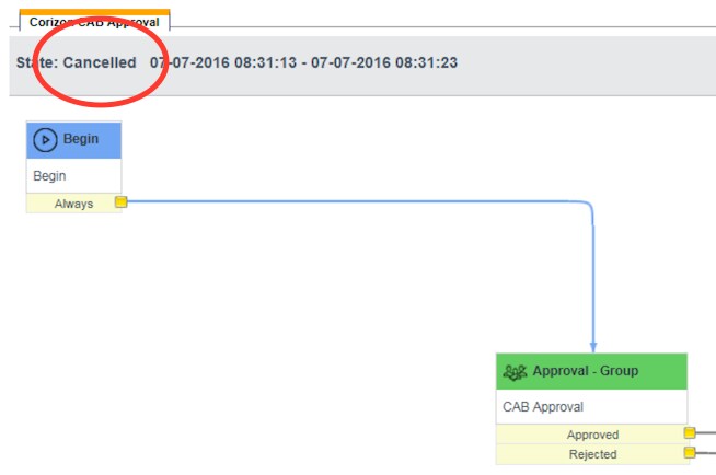

Thank you Michael, I really appreciate your working on this! I made the changes to my script to reflect what you have in bold above. The Approvals show as 'Cancelled', but the comment still isn't making it into the record for me and the workflow isn't cancelling the approval like it was before making the above changes.
When I switch the script back to the way i had it, i get this on the Approvals section -
And this on my Workflow -
It's very perplexing to me - and when I moved this into our production environment, it cancels the workflow but doesn't mark the approvals as 'No longer required'.
The field Comments to Requester, that's the Comments field?
In the first screen shot, it says Cancelled at the top.

I think the light just went off in my head.
If you look at the script, there is:
if (checkResetConditions()) {
if: function checkResetConditions() {
has nothing, the whole if is skipped, thus #1 doesn't run.
it then skips down to next fnc: function cancelMyWorkflows() {
which cancels the workflows (approval turns brown on workflow) and the approves are 'No Longer Required' with no comments, because we skipped the if
whereas, the script I'm using with a Reset Condition (current.type.changes()) triggers if, triggers #1, comments get added, workflow is cancelled, tho approval box is green, approver's are cancelled with comments.
Does this make sense?
I tried it your way and that's exactly what happen. No comments, approvers no longer required.
When i tried it with the following, the workflow showed cancelled but the approval box is green, but the comments didn't show up for me.
