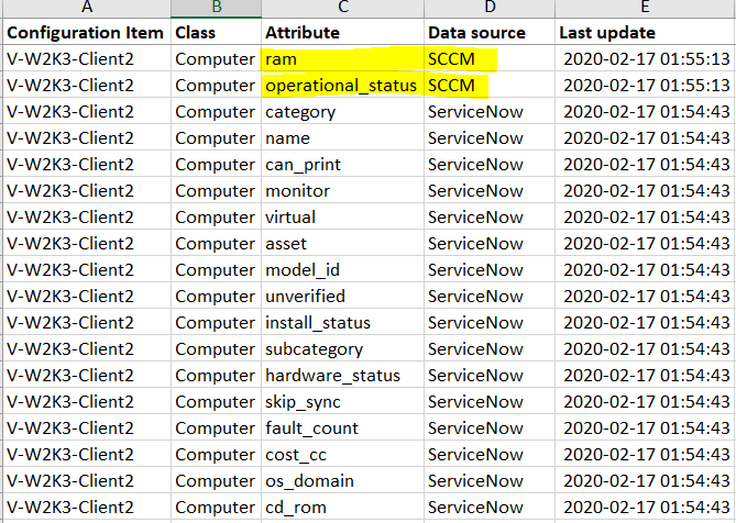

Hello everyone,
I'm using SCCM plugin and Discovery to populate the CMBD, but I'm having a problem with Reconciliation Definitions rules between Discovery and SCCM Datasource.
If, I know that the Reconciliation def. works good if cmdb_datasource_last_update is correctly populated.
I would like know when Datasource Histories is populated, because seems that SCCM not popualated the cmdb_datasource_last_update  table when a computer is created or updated, and this means that the rules of precedence and reconciliation do not work properly.
Does SCCM populates the Datasource history table? In OOTB? I have to customize onBefore Transform script on SCCM Plugin?

The SCCM integration calls the IRE, but does so in such a way that it bypasses the Datasource Precedence rules. Please follow this article on how to modify the SCCM transform scripts.
https://hi.service-now.com/kb_view.do?sysparm_article=KB0721378

ServiceNow not raccomanded usign IRE in SCCM Transform maps ( see first resolution ).
