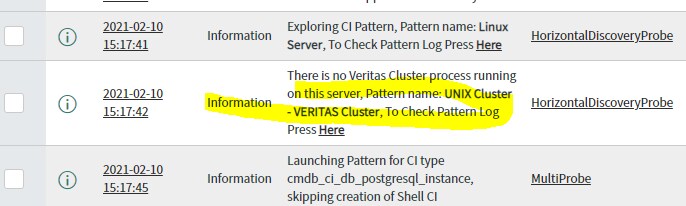

Hi Rajesh,
I am facing the same kind of error:
Error: Pattern exit because graceful termination, reason: There is no Veritas Cluster Process running on this server.
Can you please tell, how you proceed in resolving your issue, and also I am unable to access the debug of the failure patterns.
Any help will be appreciated.
Thanks.
Akshay Sharma
Hi Akshay
Linux Pattern looks for presence of veritas cluster on given Linux Box , But if its not there
then it will exit and continue discovery. You can ignore this.
Press Here as per SS - You will get this. But this you can ignore as Veritas process is not present.
It will not impact the discovery.
