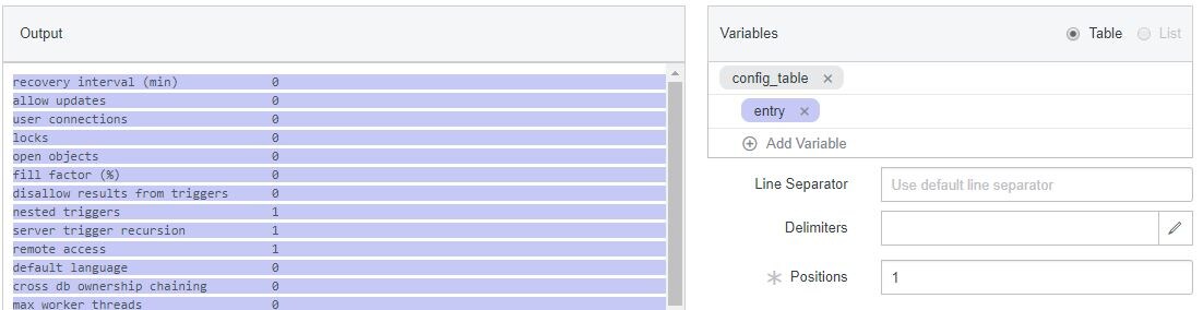

I'm parsing command output from an sql query into a variable (not a table or list, 1 position, no delimiters - so it captures all of the returned text as a single variable). When I try to write that to an attribute, it returns only the first entry, not the entire string, as if it were parting a list. Capture.JPG
How do I get it to record the entire string into the attribute instead of just the first entry?

It is a list - you'll need to capture it as a table then loop through each line to obtain the information you want.
Alternatively, amend your SQL statement to return one row with concatenated data then parse that one line.
Thanks for your help, but I'm not quite getting there.
I'm reading the output from the query into a table:
Then using the following javascript to parse through it to create one long string variable out of it:
EVAL(javascript: var rtrn = ''; var config_params = ''; rtrn = for (var i = 0; i < config_table.length; i++)         { config_params += config_table[i] + ','; })
I then write that to the table attribute.
While the javascript works, I'm getting an error in the mid-server log
12/15/17 11:06:07 (469) Worker-Interactive:PatternDebuggerProbe WARNING *** WARNING *** org.mozilla.javascript.EvaluatorException: syntax error (ad_hoc:EvalClosure-Record u_configuration_parameters; line 1)
    EvaluatorException( var rtrn = ''; var config_params = ''; rtrn = for (var i = 0; i < config_table.length; i++)         { config_params += config_table[i] + ','; })
12/15/17 11:06:07 (469) Worker-Interactive:PatternDebuggerProbe WARNING *** WARNING *** Error while setting attribute. : JAVASCRIPT_CODE_FAILURE: EvaluatorException( var rtrn = ''; var config_params = ''; rtrn = for (var i = 0; i < config_table.length; i++)         { config_params += config_table[i] + ','; })
