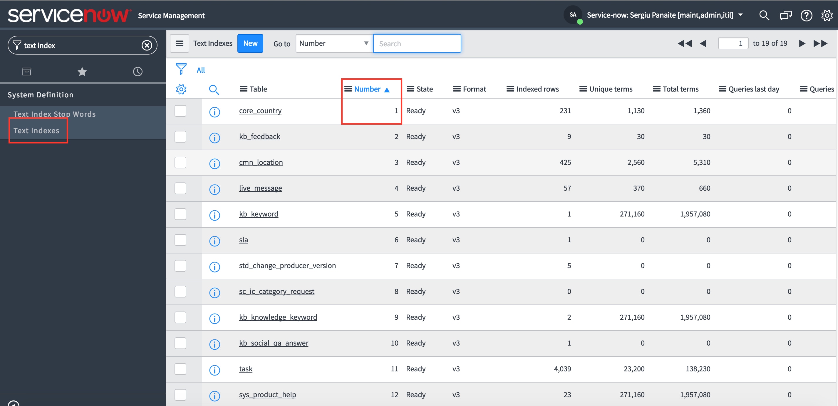

One way of fixing this is by going to Text Indexes and find the table that has number 45, like in the example below:
Once you identify the table open the record, and under Related Links click on Regenerate text indexes, like in screen shot below:
This will regenerate all text indexes for that particular table. The side effect is text search for that table during this period will not work properly.
