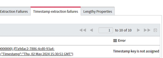

We're streaming logs to the instance though a REST integration, that all seems to be working well. However, once the log reaches the Source Type Structure, the engine isn't able to parse out the timestamp. I believe this is a required field, so I'm not seeing any results at the moment.
The question is, it appears like the timestamp I have is one of the supported timestamp formats, but I'm still receiving the error "Timestamp recognition failed: Error when sending data to 'Health Log Analytics AI engine', Contact ServiceNow support"
After saving, this error comes up

It looks like the timestamp on your log doesn't match up with the system formats. You have two options to resolve:
1. Use the source type script to change the format to something that matches
or
2. Add your time stamp to the timestamp formats table: https://docs.servicenow.com/bundle/washingtondc-it-operations-management/page/product/health-log-ana...
