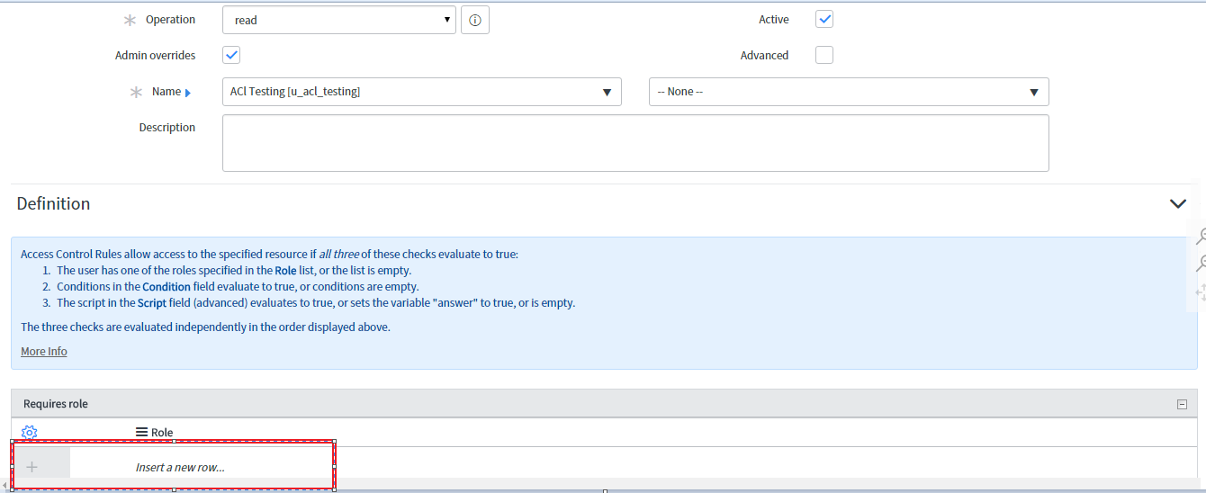

Create a Read ACl on your custom Table at the table level which would work for your requirement.
Navigate to ACl module under System Security Application Menu and configure the ACL's as shown below
1)
Mention the Table Name and specify the Role respectively for the Users you want the Read access for that table as highlighted above in red.
Hope this helps. Mark the answer as correct/helpful based on impact.
Shloke

02-24-2017 01:19 AM
Link mentioned above is a WIKI link which is only for documentation purpose. You need to login to your instance and follow the below steps to create an ACL:
1) First you need to enable the Elevated Privileges to write an ACL which can be done as shown below:
2) Then navigate to ACL module under System Security as shown below:
3) Click on New button ;
4) Configure the ACL as shown in below screen shot, just change the name of the table from ACL Testing to your table name for which you need that
