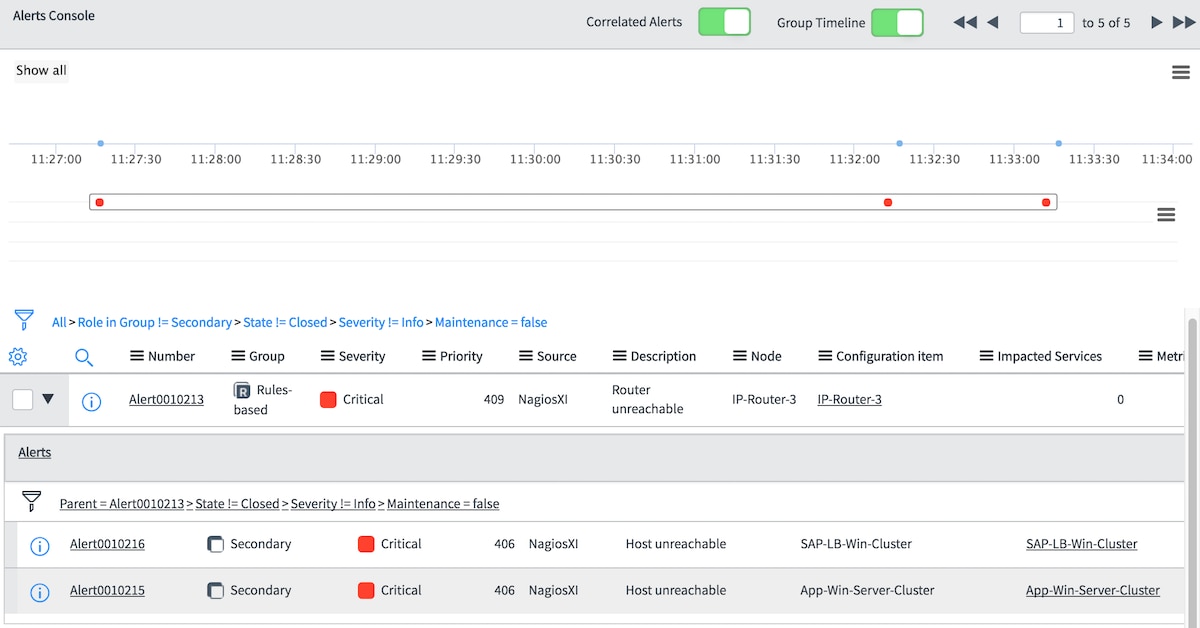

Now when an event arrives for the router and is followed within 60 minutes by another event for the Windows cluster (in this example), the Windows cluster alerts will be correlated to the router alert:
The final step is to create an Alert Action Rule and configure the filter condition to only create an Incident for an alert where the Role in Group field is set to Primary.   You may also need to set the Order field to ensure the rule is triggered before other Alert Action Rules that may also create Incidents for alerts that are not using the Role in Group field.
