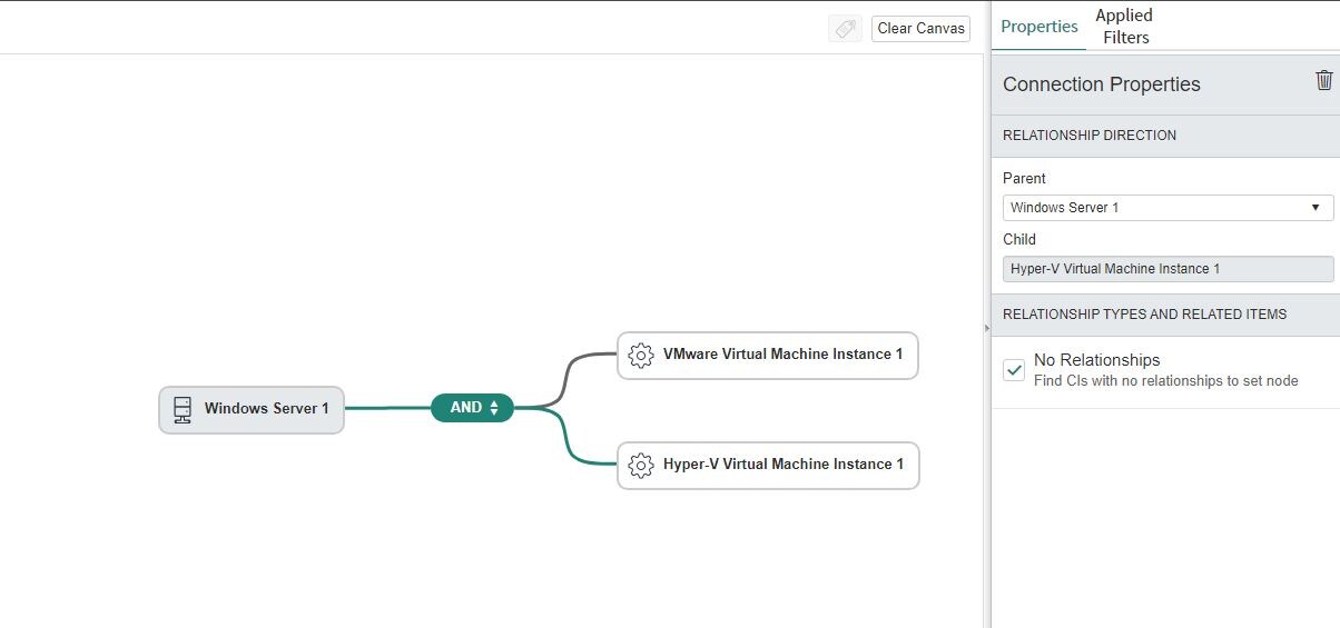

To generate a report to show this, I would use the query builder. The Query builder allows you to report on CIs that do not have a certain type of relationship to another CI .. ie missing relationships!
I have a report which takes Virtual Windows server CIs and highlights any which do not have a related ESX/Hyper-V host server, using the the relationship option of 'No Relationships'.
I've created a version of this (attached) which will report on any Virtual Windows server with no related VMware or Hyper-V VM Instance (obviously you would change the Hyper-V entry to EC2 for your instance) using the Query builder.
