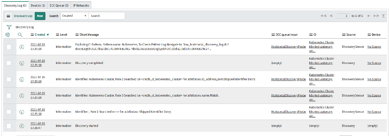

I have set up to point to the load balancer, ran the serverless discovery and seem not able to discover everything.
It only runs Pattern Launcher: Kubernetes and gives me input payload as such as a result.
I think the permission on k8s is setup correctly. here is the yaml extract of the setup:
When setting up up the Serverless pattern on the discovery schedule, I have setup:
*Pattern = Kubernetes
Run Child Patterns - checked
Parameters:
   url - "https://k8s-test-apiproxy-vip-dc2..." (FQDN of my KubeAPI VIP) - confirmed on MID server that connectivity to the VIP address via TCP 443 is working.
   credentialsAlias - "k8s" where k8s points to a k8s credentials with username and password.
   namespace - * or "service-now" - tried wild card and "service-now" namespace as defined by k8s admin
I am not sure where we are going wrong with this setup.
