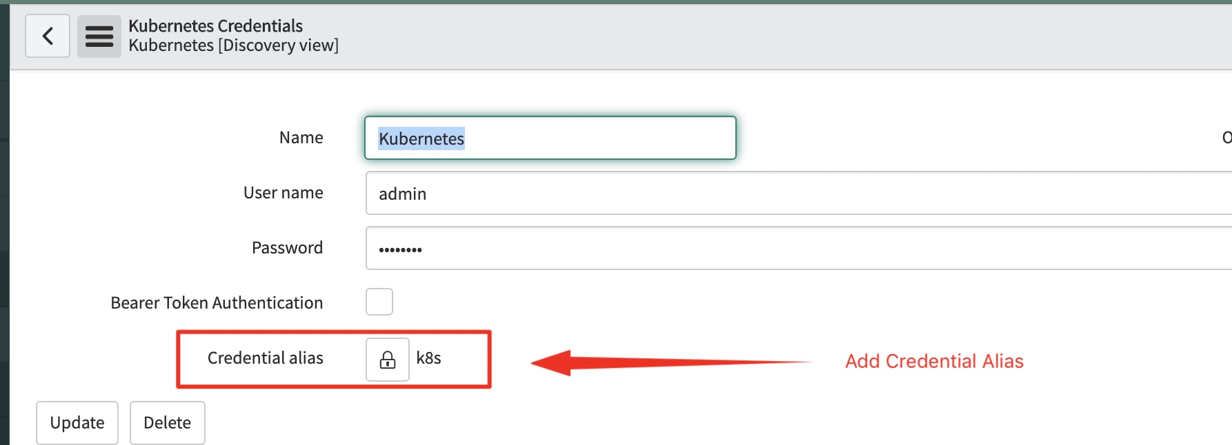

Step 1 : Add kubernetes credential to the credential table. Patter support both basic auth or token auth. Add credential alias.
Step 2 : Create a new discovery schedule and choose serverless discovery
Create new serverless execution pattern. Configure the credential alias, add the k8s cluster URL to the serverless execution parameter.
Trigger the pattern and validate the results.

I followed the steps as given in the screenshots and did kubernet disocvery.
I can see an error in the Horizontal Discovery Log -
Response has error. Status code is 401 . error code: 3 . error message: Method failed: (/api/v1/namespaces) with code: 401 - Invalid username/password combo
Any idea how to fix this error?
