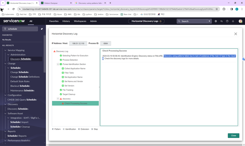

As I perform quick discovery for lab's verification, discovery log shows the following error message and is not performing normally
Error Message : "Discovery status is FAILURE, Discovery using patterns failed due to lack of existence of the main CI type in the results. Check the discovery logs for more details"

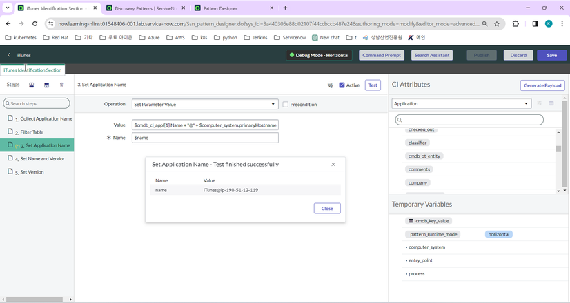

so, When i check the application(iTunes@ip-198-51-12-119),
Only Name Field is populatedVersion, Description is not populated
I captured pattern designer setting

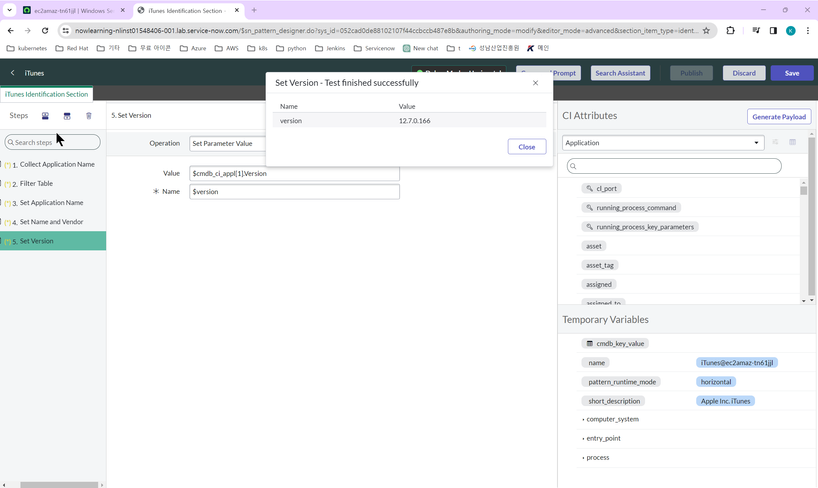

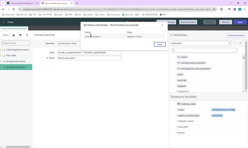

AJ, hopefully, you are still active and get this message. I went through the articles you suggested and they were unfortunately not helpful for me. I am having the same issue where it won't populate the version and description. I also get the same issue with the discovery status failure.
The first article you recommend is fairly old and the task is different. But, when I match up what I can, it feels like I'm still doing everything right. The second one is also fairly old. But, again, after watching the YouTube's, I can't find a spot where it seems I missed something.
When I run through the iTunes pattern, everything tests well. All my variables are correctly cased. I tried running the discovery straight from the Windows Only discovery schedule (which also has the linux IP), I deleted that IP range and added just the requested IP, and I also tried running a quick discovery straight from the discovery schedule table. Every time, I get that error and only the name populates on the iTunes CI.
09-26-2024 10:08 AM
So after spending 6 hours, I realize that there may be a mistake in the lab. Where it says Name: $cmdb_ci_appl.short_description, it actually should be $cmdb_ci_appl[1].short_description. You would do this for setting version and name.
09-26-2024 01:56 PM
Yes thank you! This worked for me as well. My gosh...how many hours were wasted.
