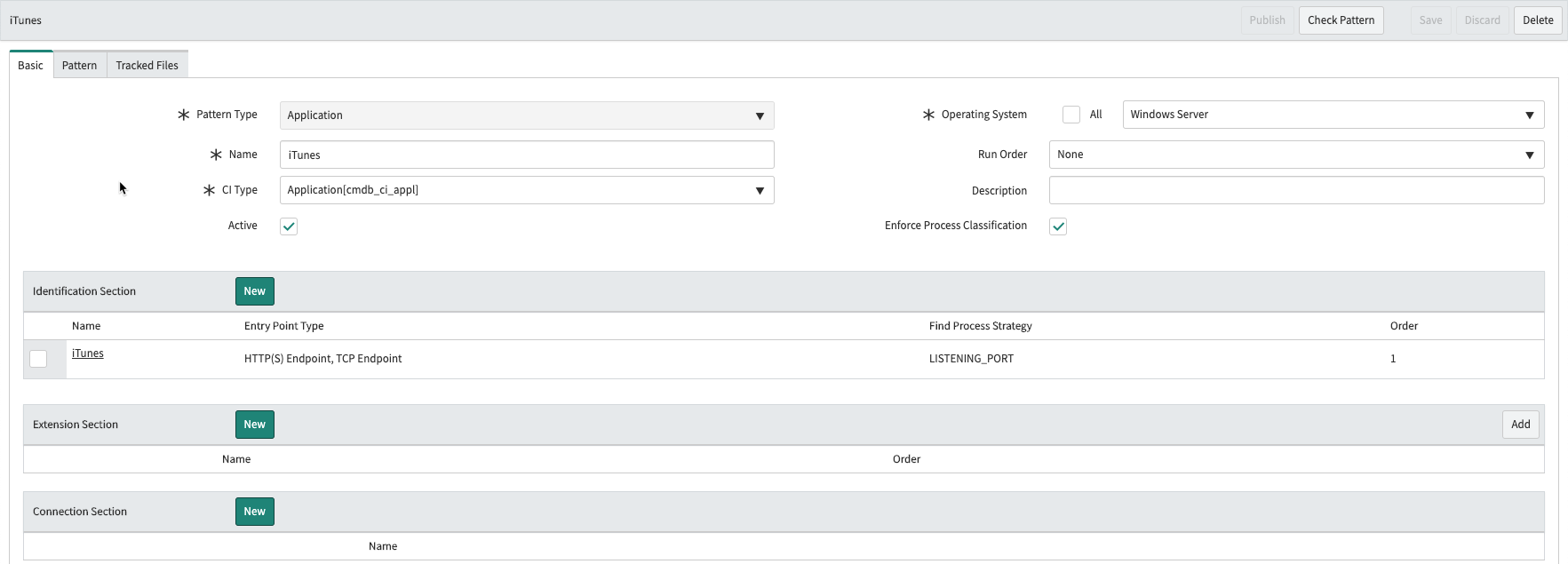

Okay, I just restarted the simulator so I could try instead of from memory.  I was able to complete both section 6 and section 10.  I'll post my screenshots of what I did.
Essentially completing step 10 definitely will do this. Note: I did restart the mid server as a just in case.  Can't say if it would be required but since I did it, I'd recommend it.
First I setup the Process Classification, (you can't add the Pattern to the HorizonalDiscoveryProbe yet, but remember you need to go back to add it in.
Then create a pattern called 'iTunes'
Standard pattern, I just made sure the OS was Windows and the entry points were entered as listed.  Make sure Enforce Process Classification is checked.
Going into the Identification section I did the following.  To keep it easy I didn't do anything fancy and just opted for simple set parameters after the initial WMI query.
Here's what I did within each of the other steps.
Hit Save and Publish
I went back to the process Classifier and added the iTunes pattern to the horizontal pattern.
Then I jumped to MidServers and synched the pattern.  Once that finished (less than a second) I just preemptively restarted the MidServer.
Then I went to Discovery Schedules and ran a quick discovery agains my mid server.
If everything was correct, you should see it running the pattern for iTunes.
I checked the Application table searching for iTunes to make sure it was created, then I opened the computer system record and checked that the app was related to the server.
I validated Step 10, then jumped back to Step 6 and validate it.
Hope this helps to get Step 6 validated.

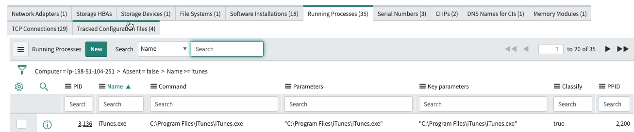

I had the exact same issue you're having.  Looking through the processes for the CI, it doesn't appear that iTunes is actually running on the server that was configured in the Discovery schedule from Step 5.
The task validation appears to be looking for the application CI made in the form of iTunes@<ip-XXXX> and not that the Software Installation table is updated.
I ended up just making sure that iTunes was loading and running on my instance, creating a throwaway pattern to go ahead and create the application CI.  Though, I'm fairly certain you can skip to Step 10 do that, and then jump back to Step 6 and hit validate and it will work. Since for Step 10 I just modified my pattern to what was asked for ( I needed to include the version info) and Step 10 marked off.
